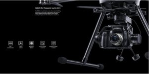

The Yuneec Tornado H920 with a GB603 Gimble (3 axis) would do the trick and is super easy to fly. It's 11 pounds (5000 grams) with batteries camera and GH4 gimble. For $5,000 you get the hexacopter, gimble, hand held solution (accepts the 3 axis GH4 gimble) and two batteries. I also recommend a cheaper way to learn and a Yuneec Typhoon Q500 4K quadcopter is just over 1/5th the cost and comes with a 4K camera and 3 axis gimble.
I agree, I just purchased the Yuneec Q500 4K quadcopter and it's very easy to fly. The Yuneec Tornado H920 looks like a great one for the GH4.
