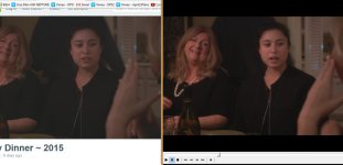

Here's a screen capture of the Original h.264 file on the right, and the 1080p Vimeo stream seen through Internet Explorer on the left.
Last year Vimeo was NOT this drastically off. And strangely, the streams of SD 540p and 320p look MUCH more like the original on the right - just in lower resolution.

Different issue. That's the Gamma correction not being the same on Quicktime vs monitor. Vimeo's issue might be similar in that they have a different gamma setting on the full HD encode vs the SD encodes. They shouldn't.
Exactly. It sure does seem that this is what's going on. I can stream a video, and then sit there and switch between 540p and 720p and watch the gamma change back and forth.
