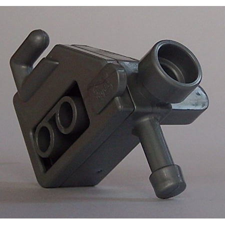

Or film it live with this:
100% Lego! (or you can do a joke BTS showing these are the cameras used :) )
