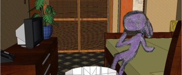

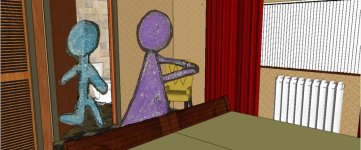

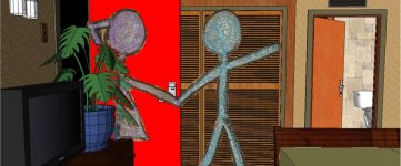

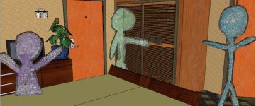

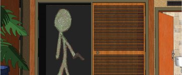

I have 3D diagrams of the motel room I am shooting in.
I want your opinion on the lighting options.
Were shooting on the SRIII - Super16
I'm hoping to shoot at ASA160 or 250
Room Size: 16x16'
2K Bounced off ceiling for ambient light -- Possible issues: May cast shadows from Chimeras?
2 Medium Chimeras (1000w or 500w ea.)
1 Small Chimera (500w or 100w)
1K bounced off reflector [In washroom] - Open door to allow additional light through it.
4Bank 4ft Kino inside washroom for additional light (not seen in diag.) for when actors are near it for more key light through open door.
4Bank 4ft Kino anywhere in room for additional lighting.
1Bank 4ft Kino outside from door under roof (Cyan colour)
300w Arri outside window onto brick wall as outdoor lamp
White/Silver Bounce boards for fill
*Actors positions:
-Front door
-In front of window
-Sitting on bed edge by TV
-In front of washroom door
This is what I have. I wanted to know what you guys though of this lighting set up.
Tips? Pros-Cons?
LIGHTING SETUP (To-Scale):
STORYBOARDS:

In about 50% of the shots, it seems as though the actors will be right underneath the Pancake light. So, it may seem as though they are lit from above rather than from the side as if from the practical What would be the options to fix this? Just flagging it from above?
^ Liked it :)

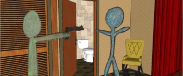

Now, as you can see in the 3rd picture, the main lights are by the bed on the night stands. The practicals will be the ones lighting the room with the aid of the Chimeras to add more light as if it were the practical lamps. Which I hope that'll work.
The thing is, by the bed it will be lit fairly well. We are using ASA-160. Most likely at f/4.0
Right by the main door is another smaller light on the wall that will be constantly flickering very faintly. It will be to light actors by the door.
But, what about on the opposite side of the room where the chair is?
There wont be enough light to light the actors their. The majority of the action takes place in front of the window and the washroom door.
I want a yellowish light from the washroom and close to white light from the practicals. There will be a light outside the window.
When the actress opens the vertical blinds, there is a brick wall about 2 feet away. And there will be one of those ugly old yellow lights.
So, I might key the actress by the window with that ugly yellow light. But, I'm not sure... What about by the chair? Its supposed to be darker in that corner as there are no lights there. They are on the opposite sides of the room.
