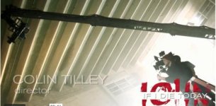

You can see here, the three rotation points in the Super-Technocrane head. See the how the camera is sitting on a L-bracket, which has the lens centered on the cross bar? That cross bar is the tilt, and there is a motor on that L-shape bracket which is a nodal-point rotation for the 'spin' effect. The pan is controlled from the top, I think I almost cut it out of the screen-shot.
Z-head, with roll ability.
Thats what i'm puzzled about. They obviously could've done it either way with the Super-TechnoCrane on set. But i'm not sure at all because the spin at 0:25 has a pan before it and that has motion blur, but the spin doesn't have any whatsoever. Only other option about not using a fast shutter would be to do some sort of clever speed ramping. But, one thing I do know is if I had a Super-TechnoCrane on set, I definitely would be doing it in camera.
