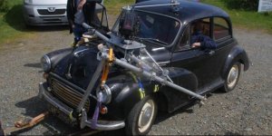

As a youngster I used to shoot for stills for a motorbike magazine. (http://www.sammorganmoore.com/bike/)
Method.
Get unsecured into an old station wagon with the unsecured tailgate open and try and go fast enough round some bends that the folloing Fireblade or Hyabusa didnt look like it was parked.
Every element was lunacy. As well as learning about the joy of cornering unsecured the other thing I remember was breathing deisel. Surely on a pro set one would reroute the tailpipe fumes ??? - I think one can add some flexi tube and take the fumes to a better location?
