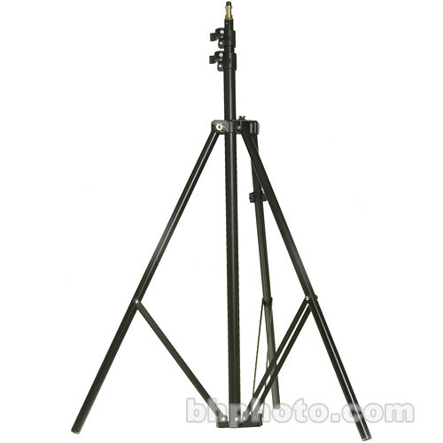

SilverWolf
Hey all,
I have the bogen stacker light stands 3320b http://www.bhphotovideo.com/bnh/con...s&Q=&sku=163388&is=REG&addedTroughType=search
The stands are great,but the locking latch is starting to get loose and I need to tighten it up. The problem I am having is that there is a bolt and a nut at the end that I can seem to find a socket that will fit. I've taken the actual stand into a auto parts store and tried different sockets but that still didn't work.I also went to bogen website and downloaded a part list of the stand but couldn't find the info I need. If anyone has this stand or know what socket or tool I can use to tighten this that would help me a lot.
I have the bogen stacker light stands 3320b http://www.bhphotovideo.com/bnh/con...s&Q=&sku=163388&is=REG&addedTroughType=search
The stands are great,but the locking latch is starting to get loose and I need to tighten it up. The problem I am having is that there is a bolt and a nut at the end that I can seem to find a socket that will fit. I've taken the actual stand into a auto parts store and tried different sockets but that still didn't work.I also went to bogen website and downloaded a part list of the stand but couldn't find the info I need. If anyone has this stand or know what socket or tool I can use to tighten this that would help me a lot.
