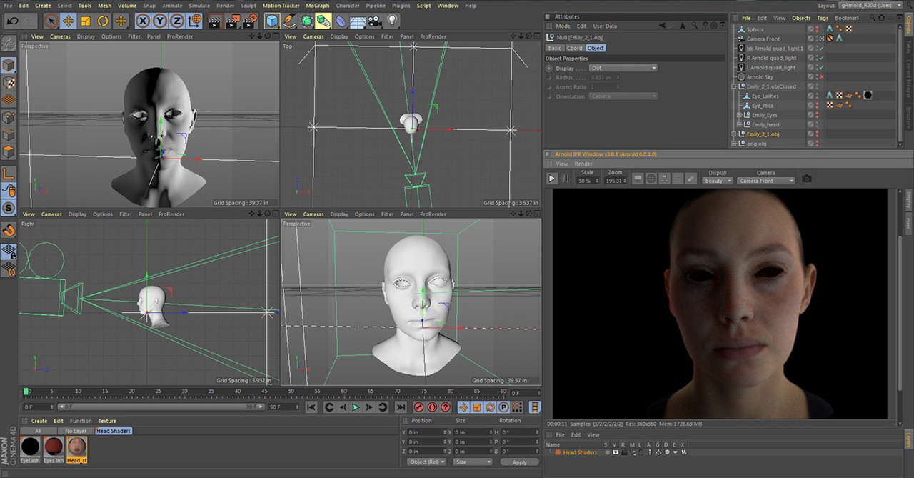

Started blocking in the shaders. Very basic diffuse and sss right now. Currently using C4DR20. Still alot to figure out yet. No eyes textured yet as the eyes textures aren't lining up right.
//update Aug 08 2020:
-The "00_displacement_micro.exr" asset is too large for my current setup to handle and hangs my C4D for too long so I'm not using that now.
-Getting the eyes figured out although my Arnold for C4D version isn't identical to the ones for Maya so a bit of shader adapting to do. The method used is interesting in this video link https://www.youtube.com/watch?v=cDizWFrHLcM.
-The eye-lashes were slowing down navigation in the viewports (odd) so turning off its preview visibility solved that.
-I have an older AMD video card, not Nvidia that's recommended but it's still managing to work using the CPU render mode.
While Arnold GPU rendering is available now it requires an Nvidia card (which I'm way over due for).
