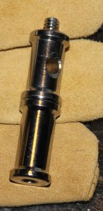

One bit of advice on purchasing these types of lights. What you want to make sure of is that the light is easily mountable to modern light gear. Some of the lights made during the film home movie days come with mounting clips that were made to mount directly into a slot on top of the Super 8mm camera. This moved the integral "85" filter (Full CTO) out of the way of the gate so that the film would register for tungsten lighting. I have found that the lights with these mounts require a good bit of modification to make them mountable to modern lighting support gear. My efforts to modify lights like this have not been successful. These is why I have narrowed the "Pocket 650s" in my kit to the "Cameralite", the "Mardi-Gras"light and a few others. What you want is a light that has some type of bracket or other mounting hardware that will accept a 1/4 20 (Or 3/8"... but I have passed on this for the sake of consistency in my gear) screw or bolt. To mount the "Pocket 650" in my lighting support gear I use an inexpensive variable spigot and bolt it to the bottom of the camera mounting bracket:
I then use inexpensive umbrella stand mounting adapters to put the light on stands with tilt capabilities.
These mount adapters come with the variable spigots, but I suggest getting some more to have around.

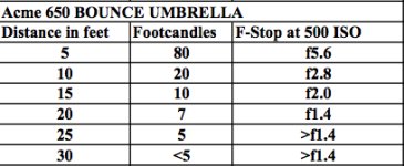

Here is the photometric info I have come up with testing these kinds of lights.

Umbrella bounce:
