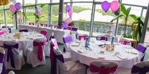

Here is a picture of one of the potential locations, you will see the outside is completely blown.
in this setup id place the light camera right and fill from the left with a silver board, keeping the backlit motivation alive
