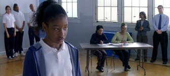

I thought he was talking about split-focus diopters, like the ones M. David Mullen, ASC used in Akeelah and the Bee.
Foreground subject (Akeelah) and background subject (teachers at table) are in focus. Slight blur at the camera-left edge of the table.
Split field diopters are the same thing. Must be a regional thing as far as what they're called.
