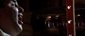

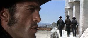

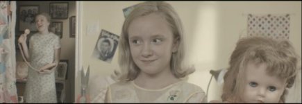

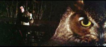

Has anyone used those split field diopter filters to achieve effects (pictures)? We're filming next month and would like to try to use them with some shots, possibly on a Sony FS700 or F55.
