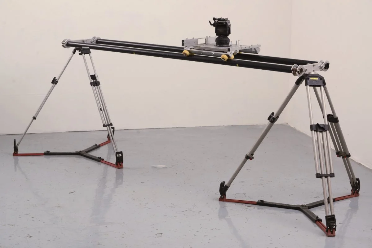

Cheap sliders and long scaffoding runs/dana rigging can 'sag' especially when mounted between two light stands.
Sagging is actual flex in the pipes, typically when the carriage is in the middle.
Here is my 'dana' built with two tripods.. at 2.4m it will 'sag' https://images.squarespace-cdn.com/c...G?format=1500w
One can stop this sagging by use of shorter pipe or a central support.. both of which I have but dont have a photo of.

What are your pipes made from? Mine are made from thick aluminum and there is no sag, at least none that could be seen without some very fine measuring.
My 'dana' track is aluminium scaffold tube (uk 48mm diameter)
I guess sag might be a poor term.. they tend to 'fail' on having a small resonance .. Im talkig at the 100mm lens zone there can be some bounce.
This is often 'cured' by bridging with apple boxes.
polished steel tube might be an option?
RIgging on the double 100mm bowl is potentially (while easier to level) more flexible than a mitchell or other flat head tripod or combo stands.
