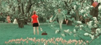

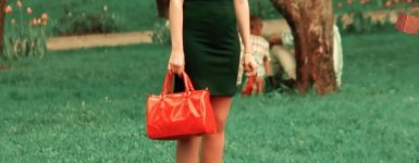

I stumbled across a piece of video on youtube which has a look that I found interesting. The look isn't likely anything intentional and, going by the nature of the series of videos, is probably just amateur happenstance. But ,either way, I really like the look:
1:31 mark and onward.
What's going on there? There is a green cast but not, imo, in a bad way if you are doing something stylized. The green foliage has a silvery-green cast to it that is different from the green-cast you get under fluorescent lights. It almost has a Technicolor look happening. The crazily over-saturated look will likely cause some of you to cringe, but I like it. It is in some ways the complete opposite of the milky and desaturated "s-log" look that is the current fad.
Even if you hate the look, would you be able to re-produce it? What do you speculate took place to end up with that end result? For those of you who know post, is this something you could re-produce in post using footage that was "properly" white-balanced in acquisition? The video is "normal" prior to the 1:31 mark. As if the shooter did something unintentionally whacky to the camera settings after shooting the intro with the host of the series.

Looks like it would be pretty easy in Film Convert or Magic Bullet. I am not a good enough colorist to tell you specifically how to achieve it but I know some colorists who could nail this look in :30. I'd never try to get that look in camera, it's too extreme and if you changed your mind, you would be hosed.
Looks like cross processing, probably trying to emulate the look of Soviet era telly.

What's the possibility that they just screwed up the WB in-camera and this was their attempt to fix it?
it is interesting, chuck a frame into resolve, eyeball the scopes and go for a match, import your own frame of some one in the park, go to work.
The green is high (hue vs lum) but not saturated (hue vs sat) - the controls are there for you to play with.
