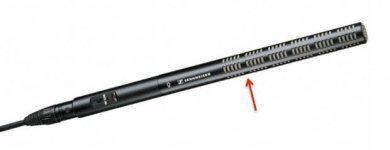

It's to stop dust and debris getting into the tube and is also part of the damping of the capsule.
The capsule itself is very far away - it's down at the other end of the tube, marked with the red arrow on the attached picture.
A dent in the top like that does not matter at all.

The diaphragm in that shotgun is way back near where the battery goes in. http://www.soundonsound.com/sos/dec13/articles/qanda-1213-01.htm
Actually, the diagram in that artical is slightly wrong as the arrow does not point to where the capsule actially is correctly.
I have annotated the diagram so the RED arrow points to where the capsule actually is and the vertical red line is about where the diaphragm is.
The holes behind the capsule are required to allow sound to get to the rear of the capsule to make the basic super-cardioid pattern of the capsule.
