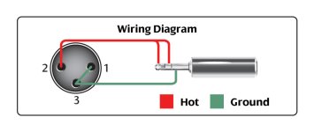

If you are taking a balanced signal and recording it to a TRS stereo input, you need an adapter cable wired properly:
I would also probably just use one channel. But in theory inverting one and then summing them together would give you a +3dB gain and cancel any hum/ buzz that is there, but only if you are exactly 180 out of phase.
In your case it sounds like you have plenty of gain, don't have noticeable hum or buzz and it sounds like it's not exactly 180 degrees out of phase. If it was it wouldn't get lower it would be gone. If they are not exactly 180 out of phase then inverting and summing would produce big problems.
