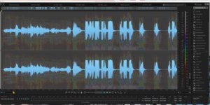

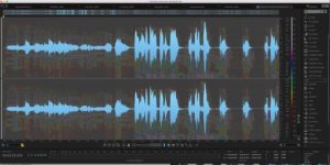

I ran your sample through Izotope RX 6 I did a pass of declip, adaptive phase rotation, gain, and then another pass of declip. The voice was distorted but the accordion was pretty clean which tells me the voice was over modulated on the recording. Not necessarily from the mic being touched but from the mic being too close to the mouth and the gain up too high. Looking at the waveform in RX the tops and bottoms of the vocal's waves were squared off. I'll try to upload the cleaned up version.
and here are before and after screenshots so you can see how the waveform was changed.

EVeryone does things their own way but I would always advise recording lower rather than hotter. . .if it's TOO low when all is said and done, a little hiss/noise in the signal from being brought up to proper levels in post still usually sounds better than overmodulation.
+1
Audio Clipping / Over-modulation is kind of the equivalent of blowing out your whites ( highlight clipping ) when shooting video.
In both cases it's better to record at a lower level to prevent clipping, and then you can then adjust things in post to make corrections.
