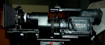

I figure that if I flip it upside down I can see the power light better so I flipped it. Not only I can now see the light, but the image is perfectly centered.
I need to figure out how to use the rails and matte box I have and spend as little as possible to mount the FF and matte box.

No problemo I found a cheap solution. The Cavinvention here it is.

I just posted a picture of my new CAVINVENTION :laugh:
The best thing about it is that the GG is perfectly center. I love it.
It took me an hour to back focus the Nikon mount, but I am happy.

Very interesting. Please post a closer image of your ingenious rig so we can inspect this Zacuto killing solution. Any additional info is great too. Thanks.
Letus makes an extended riser - put an additional rail mount on this and add another set of rods - voila - snorkel up issue solved.

Here are some shots of the CAVINVENTION :grin:

shame it doesn't work with the ex1 as the monitor gets in the way despite zacuto using it mounted upside down in their photos

Like the looks of the setup but can't find that riser on Cavision's website. Do you have a part#?
I used the Letus rod support to hold and extra Cavision rail support that I had from another camera.
It is actually very easy to do. I just need to buy extra rods.
