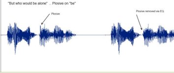

IMO, the actor's content is fine, the delivery is subjective, so if it works for you.. By means of 'thin', the tonality of the voice seems to lack 'body' or lower mid-range. "Plosives', refers to breath pops ie: blasts of wind hitting the mic's diaphragm. They are quite audible with fulll-range speakers and sub-woofers. In your case, they can be 'fixed' in post without re-recording, a multi-band limiter can attenuate these or they can be surgically altered one at a time.. depending on the situation, this is usually faster, easier, cheaper than ADR or re-recording.
