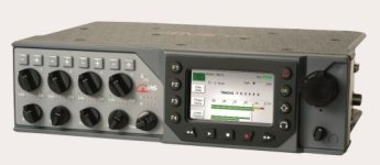

Hello, I shoot weddings and industrials, but lately I've been getting fairly serious about my own narrative projects. For my videography I use Sennheiser 416's, Sennheiser G3 lavalieres, and of course a trusty boom man.
I've avoided diving in deeper with audio because so far, clients haven't had a single problem with things the way they are.
But honestly, I don't feel it's up to my personal standards, and if I'm going to continue with my personal projects, I want them to sound a little better.
So here's the package I've set up at B&H:
- Sound Devices 744T
- 2 Schoeps CMIT5U's for our outdoor recording
- 2 of these for indoor recording: http://www.bhphotovideo.com/bnh/controller/home?O=WishList.jsp&A=details&Q=&sku=377424&is=REG
- And my two Sennheiser 416's for the occasional humid environment it seems the Schoeps don't like.
I've thrown in a couple boom poles, shock mounts, and windscreens as well.
Is this overkill for narrative work, not enough, just right? Any help is greatly appreciated!
If you are being serious I would get the 788T over the 744T as the 788 has 8 mic. pres. and the 744 only 2.
At a slightly lower cost, also consider the AETA 4MinX - this has 4 mic. pres. of superb quality (better than SD from what I hear), 6 tracks and can mix to a further two stereo tracks.
Regarding the mics. Personally I would either go for the new Sennheiser MKH 8060 (considerably better than the old 416) or go straight to the SuperCMIT and by-pass the CMIT 5U completely.

Can anyone elaborate for me why it's necessary to have a CL-8 paired with your 788T? Can't the 788T be used as a stand-alone in most smaller productions?
The only "volume" knobs on the 788T are the small trim knobs.
They are input gain, and can obviously be used but they are so small that it is difficult to use them on a regular basis.
They were designed to be used to get a rough input gain volume, then pressed in to get them out of the way. Occasionally needing
adjustments, but not to constantly mix on.
Also because they are input volume (trim) knobs you couldn't use them to create a post fader mix.
By all means you could use them in a pinch , and there is even a set up that can make the "trim" input gain "software based" and you can then use the small physical knobs
as post fader volumes but I don't think I know anyone who uses it that way.
It would kind of be like having a video camera with a software menu to control focus.
If you've ever used a Mackie style mixer. You know the trim pots at the top?
Imagine mixing a show with those, and all the problems that arise trying to.
The CL-8 does have added routing functions to make things like that quicker as well.
Also slate mic/button..etc.
Once again you COULD use the 788T by itself but a real controller is going to make life way easier.
