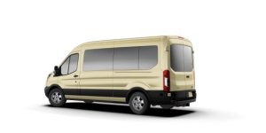

After much research and thought I am now considering buying a passenger Ford Transit passenger van (called wagon) instead of the cargo version and then taking out most of the seats.
Since you guys are in this field I wanted to ask your thoughts on the matter.
I need a van to haul gear and also 1-4 people.
The reasons I am now thinking of getting the passenger wagon are:
1. I need extra seats and the Cargo version does not have any (only driver and passenger).
Adding aftermarket seats is VERY expensive if done by the 3rd party companys.
If I do it myself there are liability/insurance issues in addition to the hassle of cutting, drilling and installing.
2. The Wagon has removable seats so I could remove all but the ones I need and even reconfigure them (to a degree). Once removed, the floor is flat.
For hauling crew, the wagon certainly has an advantage.
3. better outward visibility if I install perferated decals on the side windows
4. could be used for family vacation if I took all my gear out
The disadvantages of using a wagon over the Cargo van are:
1. The wagon costs more
2. The wagon has windows on the sides. I was thinking of decalling over them to help hide the fact that it has side windows for theft reasons. I was planning on installing protection for the rear windows.
3. The wagon has side curtain air bags
4. storing gear will be more trouble in the wagon since it has a full interior and ceiling.
5. you lose some headroom in the wagon due to the false floor and ceiling. I can almost stand up straight in the cargo, not so in the wagon.
attached are photos.gold wagon2.jpg2015-ford-transit-van-interior-facing-rear.jpg
