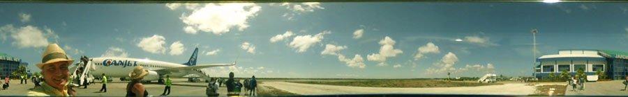

I have had a lot of fun with my Sony Bloggie Panorama camera -- it shoots a 360 degree panorama onto a 1920x1080 30p annulus. From that source file I use Bloggievideounwarp ( http://www.flong.com/blog/2010/open-source-panoramic-video-bloggie-openframeworks-processing/ ) to create a ProRes file -- this looks immensely better than the awful software Sony supplies to deliver a mediocre wmv file -- which can be edited in an ordinary way in Final Cut. Sometimes I prefer to generate a version from the now flattened by unwarper file that uses a window view -- my experience is many viewers can't relate to a 360 degree view when presented with the entire view at once -- and for that I use tools I found at this site http://www.ryubin.com/panolab/panoflash/index.html I'm not enamored of Ryubin's direct from annulus abilities, so typically I use the flat video view from the unwarped file, but in fact you can go direct from an annulus using this software. The 'advantage' here is you get a window view where the viewer chooses to pan around the image -- easier to comprehend, though less exotic a view.
I haven't worked with stills, though I believe that Ryubin's software will. Check the Downloads page for various examples -- with a little time and experimenting I figured out how the XML system worked from there.
Follows are two images to help explain what is being done -- they've been down sized to make them fit, the unwarped file is otherwise very wide.
