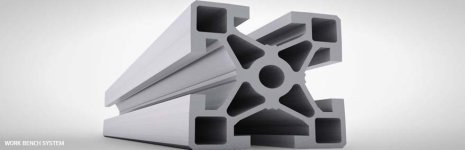

For a hombuild I would consider one of the aluminium extrusion sytems, or aluminium scaffolding.
Please forgive my ignorance but I have no idea how the picture you posted would help. I assume the camera would fit to something that sits in the 'divets' on the sides of the piece?
Yep if you are handy this extrusion stuff would offer mounting the camera on any of the four sides. Various companies make systems like this selling corners and other bits.
