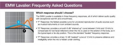

About the different response curves, I agree with what others are saying. There's a bit of info on the Countryman site about the three curves available with their EMW mic (the OST 801/802 has a similar shape) that might be helpful for understanding that (but not related to how "loud" the mic is):
Some more info on that Mic: https://countryman.com/product/emw-omnidirectional-lavalier/
But ya, OST can best answer your question, I think...
