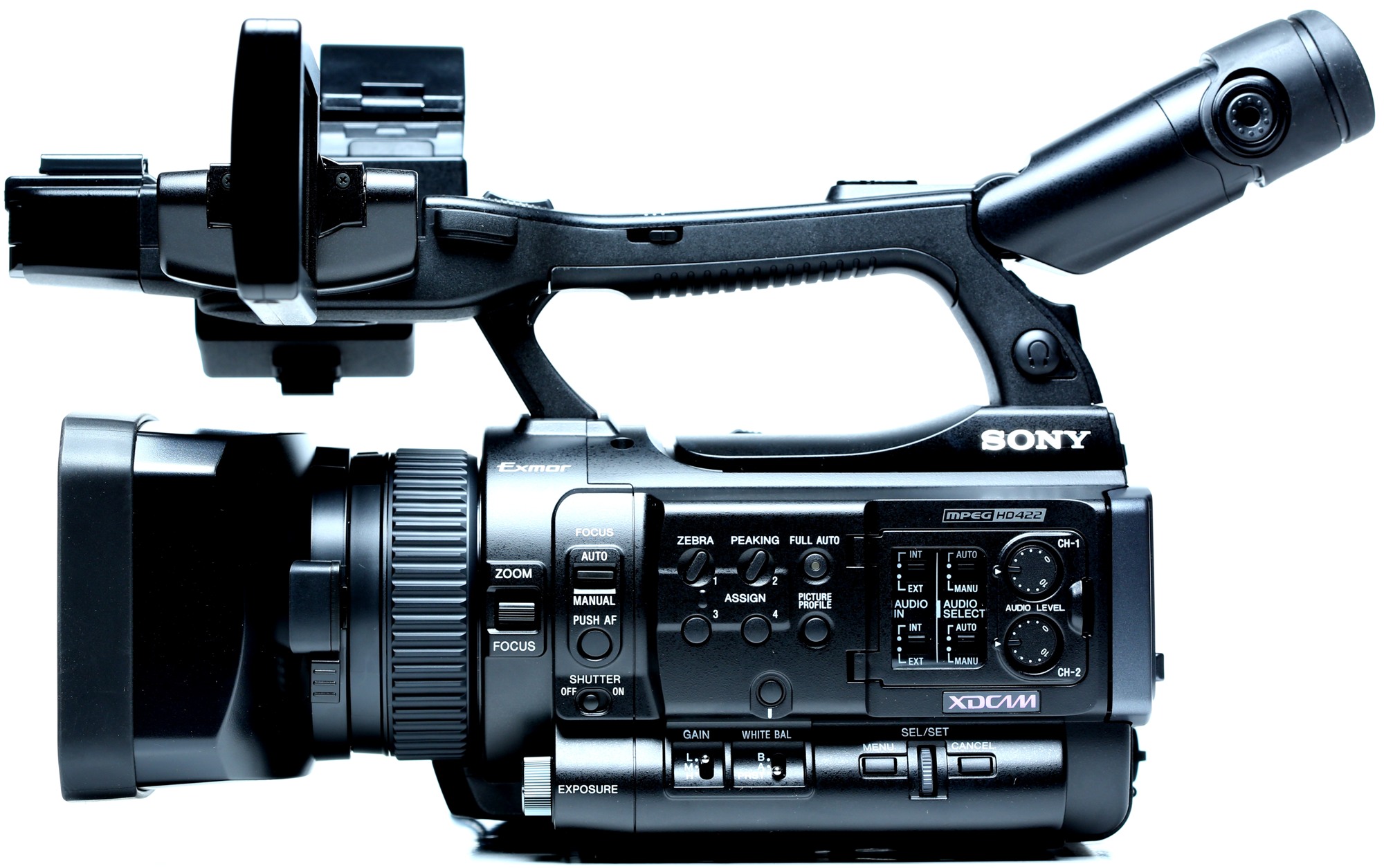

The wireless element is confusing you - Wireless transmitters don't normally supply phantom power, which is 48V, and requires the mic to device connection to have 3 conductors - normally a screen and two conductors for the audio. The power is 'piggybacked' onto these two. The more usual microphones connected to wireless transmitters do not use phantom power at all, they use a different system. If your camera connects to a microphone with an XLR cable, and needs phantom power, then to convert this to a radio link is more tricky. You can purchase plug in transmitters that have an XLR female connector, so you could connect to a normal microphone. Some, but not all, can deliver phantom power. In practice, if your camera has XLRs and phantom, then when you connect a radio system to it, you should turn off the phantom as it's not needed. At the other end, then, if your microphone cannot work without phantom, you are stuck unless you buy a less common system. Plug on transmitters are bulk and heavy, and to use them on normal lav mics involves lots of gaffing about with adaptors to get you the low voltage power a lav needs. In practice if you need to use lavs AND condensers that need phantom, you have to buy an extra TX.
When you are using a wireless system, you are NOT connecting a MICROPHONE to your camcorder, you are connecting the wireless RECEIVER.
