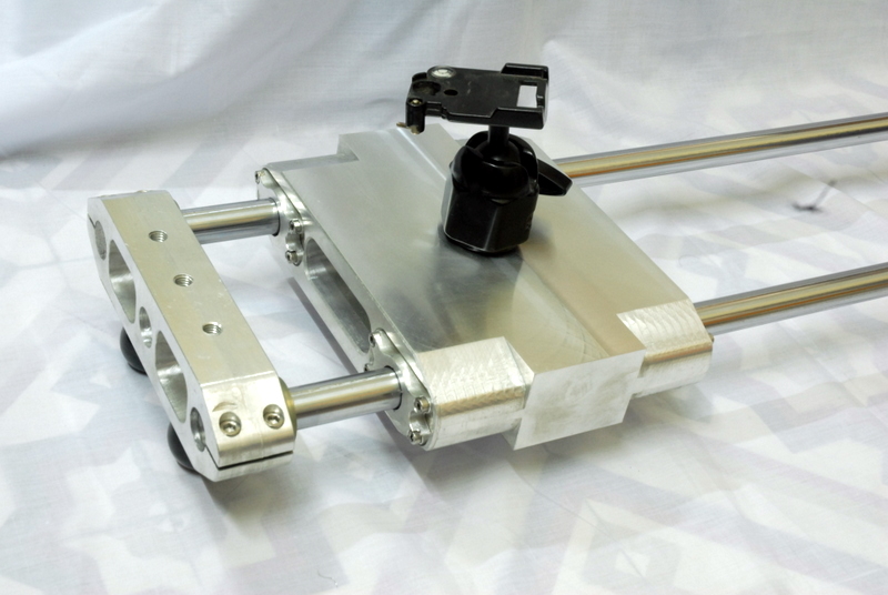

Hi all , I'm from Viet Nam , I'm not professor in film make but professor in machinist :grin: My friend request to make for him some kind of dolly ,through dvxuser I do some
Dolly with 2m , max load in center > 25kgs for Betacam, I daughter test for me with 28kgs:thumbup:
and 1.2m ,1.5m with 10Kgs max load in center for DSRL
All they run with ball bearing and Chrome coating rod hard and strong .they force dolly slide with soft and smooth :grin:

Thank all , You right ball bearing when run in dry and move fast you will hear noise . when run with grease noise reduce of course I installed the seal to keep grease in side bearing only if not rod will dirty too much.
and test with 10LBS rod non curve

Thank again for your comment . I just ask the shipping agent for shipping cost to USA ~120usd and Germany 110usd 1.2m dolly net weight 5.5Kgs packing 2Kgs. I forgot to tell you , 1.2m dolly pack in leather case , Now in my friend to make, when done i will take some picture with complete set.
http://www.dvxuser.com/V6/member.php?31135-Postmaster@ Postmaster : 1.2 mm max load up to 15Kgs with 14mm chrome rod , if you want to order 25kgs max load . I will use 20mm rod with double cost 1.2m and shipping cost will be raise . Another solution is I will mix 14mm rod and 20mm rod 1.2m length, I think this will be great :)

ball bearing , very smooth when roll , but they make noise and can not record in live. I think must be have some thing to isolate ball and rod , grease is good but still noise, new crazy project is ball bearing with lubrication liquid hope they will more active to cancelling noise
