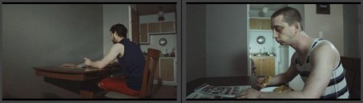

Scene 5 - Morning
Scene 5 - Morning
I had hard times lighting these scenes, which takes place in the morning. We had to shoot after dusk, so I brought some halogen lights behind the camera. There was enough lighting, but I didn't have anything to "soften" the lighting, so it's a bit harsh. I hope only people working in the domain will notice it when watching. Other than the harsh shadows, I'm satisfied of the results, unless I'm missing something?
Shot using the 18-55mm lens at f/3.5, ISO 320 and 1/48th.
MVI_2767 (0-00-30-13).jpgMVI_2770 (0-00-20-15).jpgMVI_2773 (0-00-25-17).jpgMVI_2776 (0-00-21-05).jpgMVI_2777 (0-00-04-11).jpg

* Scene 5: the first two shots look cheap, probably because of the location, but also the lighting. Not sure how to fix it (as I said, still learning...). The third and fifth are fine.
What do you mean by cheap? I choose to shoot there because of the minimalistic look of the appartment. Btw, I live there! ahah
About the lighting, not much to fix there. I've used 500w halogen light to simulate the sun, but didn't used the "frosted" glass on that one to diffuse/soften the lighting. So shadows are a bit harsh, but it's too late.
I mean that to me it lacks production value: whereas other shots here look like something I could see in a big-budget movie, that one looks like something I would expect in a cheap short produced by a small group of friends. Which is probably what you're doing, but hey, you would trick me with some of those other shots...
Oh I see. There's no time to reshoot, as he now has shaved both hairs and beard. But I'll try to see if I can crop it or something. The same comment has been mentioned on another forum. It was about framing more than lighting, but maybe a "closer" look on him might save it.
I did some quick tests, and to my eyes, this was the best shot of them. I wanted to illustrate that he was lonely, living alone in a very mundane apartment. Very minimalist concept. Simple life, simple routine. Nothing exceptional. I thought that with the kitchen it was showing enough stuff to illustrate that.

Fixing Scene 5
Fixing Scene 5
So I tried to "save" that scene in Post with AE, here's a comparison:
Scene 5 "matched":
compared to the original:
and the scene 14:
Still not perfect, but considering the first shot has been shot without a backlight, with the kitchen lights turned off as well, I think this it the closer I could get to "match" the shots together.

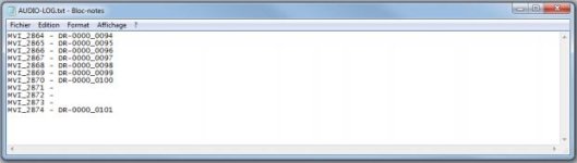

Organized Medias - Audio LOGs
it's clearly better now
Thanks! I think we might have saved the shot finally. We'll see if I can go with, or without, during the editing process.
The magic of scheduling shoots! I'll shoot the final scene tomorrow with one of the actors. Hopefully, I have sorted the scenes each time I've transferred the medias on the HDDs. Will be a lot more easier in post..!
In each Scene folder there's an audio log sheet:
Don't know how pros are doing it (organizing medias) but so far, it works well for me that way.
