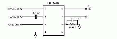

you can get a simple timer, triggered/synched by the video output of the camera.
you can find for very cheap a video pulse extractor (the chip LM1881N cost 3$ per five piece)
You are interested by the Vsync that is the start of each picture
once you got the pulse you can trigger anything (preferrably a led light that is fast and powerful)
then you can use a simple 555 chip that will convert the pulse into a longer pulse (monostable)
for the full picture duration
and eventually another 555 that will allow to skip n pulses to get a slower strobe.
