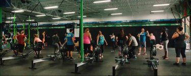

So I'm shooting a run n' gun little spot for a chain of gyms. Not going for super high-key and corporate-looking but also not super dark & moody. Naturalistic. Around a 3:1 contrast ratio. Super guerrilla style with not much crew. Attached some photos of what I'm dealing with. I can turn off the overhead fluorescents if I want to but it might make the gym too dark, which I probably won't be able to get away with for every scene. I want to get 2-3 very slight variations in looks. 1 for general gym-look with overheads on, 1 for warm morning sunlight streaming in, and maybe something all natural light by a window with overheads off.

I'm wondering what you guys think I can do to make the most of this shooting scenario. Just trying to maximize perceived production value in an environment that might not be inherently super cinematic. I'll be trying to limit wide shots and try to have at most 2-3 people in frame. Realistically I'll probably have to end up shooting 1-2 s*%tty-lighting wide shots at like a 28mm. Here are a couple of thoughts I have:
-Have a raw, energetic handheld camera, staying around 50mm. Try to have interesting interesting compositions, shooting thru things, having objects pretty dirty in frame. Fluorescent lights out of focus in background as much as possible for some bokeh. Trying to shoot at ISO 800 , f2.8. Some 48fps unless flicker becomes too problematic.
-For general shooting around the space, which will be 50% of the shoot, I feel like my go-to will be driving around a Kino or Softbox on a roller with a 1/4 plus green or whatever I need to get close to the color temp of the fluorescent lighting, very dim, just to get some light into the eyes and create a little bit of shape on the far side. Add 1-2 floppies on the near side as well
-For a slightly different look, turning off fluorescent lights and placing talent by window, and then splashing a background wall with a slash of hard light OR taping a couple quasars to the wall to act as practicals in the background
-For another scene, placing a fresnel with Full CTS as a strong backlight, add a bit of haze, 4x4 beadboard from the front, and try to create the look of morning sunlight streaming in thru a window. Shooting very tight shots since there's such limited lighting power
Any other principles you guys think I can apply to make this look as intentional as possible and less like a s*%tty-looking doc? Thanks in advance!
