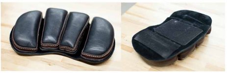

Some find that a pad like this helps prevent lateral roll-
https://www.bhphotovideo.com/c/product/904106-REG/letus35_ltm_sp_mcs_shoulder_pad.html
