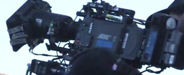

I found this behind the scenes video (and it is Hawk lenses, FTW) :)
Here is directors monitor from Alexa feed. Clearly the center box is for protecting the image for typical 2.40:1, while the outer image is the wider aspect and is 3.55:1.
