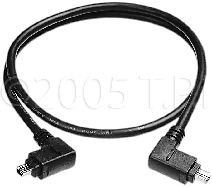

ok i'm glad someone is ahead of me on this, i am doing a LOT more stuff lately where i wish i could use the dv rack and having had my firewire port blown already on my dvx i'm paranoid...
i would like to make something a lot like this but with just a velcro strap running vertically so it could be quick disconnected.
i've been looiking for right angle cables that are 4 pin and preferably 15-25 feet.
where did you get that 4 pin right angle? i've only found 6, no 4-4's
matthew
