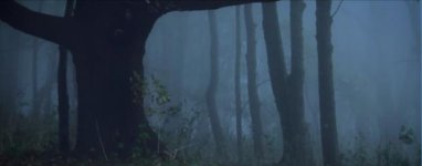

Do you have any screenshots of looks you've seen similar to what you'd like to achieve?
Capture.jpg Here is a screengrab of what the director sent me. This is what we are looking for the quality of the moonlight.
Thanks for the advice It is something I had not previously considered.
No problem. So from that screengrab, the most prominent feature is the haze. That will actually help to spread the light. It also obscures the distant background which helps you not have to light it deep deep into the woods. The light also appears to be coming from beyond frame right and also back into the background. The haze also gives a nice backdrop to shiloette the foreground trees.
You said it's going to be stylized. Depending on what you want, I've seen moonlight that's hard and I've seen moonlight that's soft. So that's up to you, but the haze will help soften things.
I'd recommend taking your largest, most powerful light and backing it up and back as far as is practical. That way you aren't dealing with such harsh falloff - the inverse square law means as your light gets farther away, the 'steps' of difference in output are over a longer distance. The moon, or sun for that matter, is very far away. Also, the further the light is, the more uniformly lit everything will be - no scalloping visible in frame.

Not knowing the context of that screengrab, it looks more like a foggy morning than an actual night shot, underexposed to make it seem more night-like. If that's really the look you're going for, given the limited resources you have, shooting at the right time of day will probably be your best bet.
just throwing this out there, for some reason there's some obsession amongst dps with lighting from the back, but 3/4 from the front will give you shadows in the frame just as easily, and if the key is softened you may not need any fill (You'll likely need fill if you light from the back).
agree though that not lighting the background is the biggest amateur giveway noone ever talks about.
