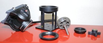

Until a solution comes along to use the FSB4/6 heads, I have been using a Manfrotto flat base head with Manfrotto 75mm ball adapter on a Kessler 100mm high hat w/75mm adapter ring. The Manfrotto head is certainly inferior to the FSB6. The tightening handle (knob) will not work on the FSB since it is a slightly smaller sized thread, and metric.

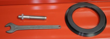

I found a tightening knob that fits the FSB-6 stud. Problem is that the stud is not long enough to get through the "washer" with enough length to screw the knob on. Needs to be at least a quarter inch longer, preferably an inch longer. Sachtler sells an adapter kit that includes a longer stud. If the thread pitch is correct, than that should work. Kit looks to be about $80.
Kit arrived today. If you get the Kessler High Hat and the Sachtler Adapter Kit FSB / 75 on Hot Pod (Model Number S2024-1500), you'll be all set. The tightening knob and "clamping washer" are included with the High Hat, along with 4 smaller knobbed studs for attaching high hat to CineSlider. This adapter kit cost me $88.00 at Adorama and they had it in stock. The replacement stud is 3/4" longer than the original and is easy to swap out with the included wrench. I checked how much adjustment range I got with this setup and it looks to be about 16 degrees from centered/level position. That's pretty good in my opinion. This isn't some hokey setup, it all feels nice and solid. Okay, some more photos.
