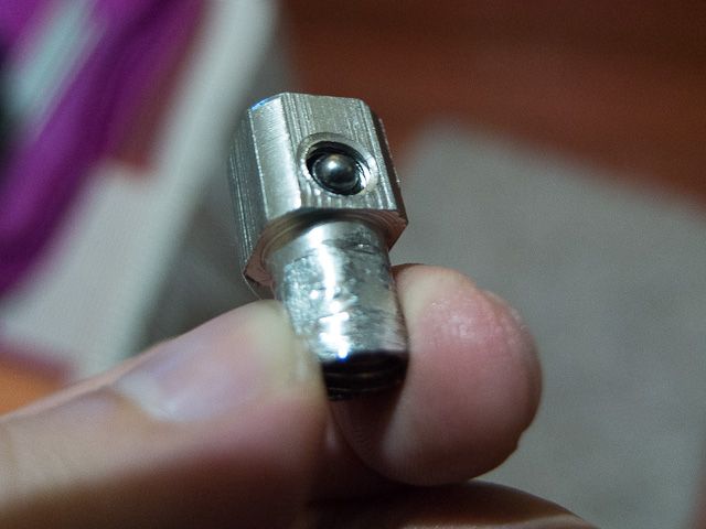

Here's the part in question
The whip broke off when we were pulling on it. I can push on it but I can't pull it out of the socket.
It would be very difficult for the ball to lock in place unless there was some manufacturing defect. Is this the first time you put this whip in this FF?

I added a few drops of all purpose oil, wiggled it a few times to make sure everything was properly lubricated and just yanked it out like a sore tooth.
I suspect the metal ball bearing was the culprit as it left scratches on the thing.

That ball is sticking up very high and doesn't look like it is properly crimped in place. Does it depress into the hole or is it just solid? If it's solid, that is your problem.
Your suspicions were right - the ball bearing doesn't depress at all. Whether they made it that way or not, I'm not sure.
I have the EZFoto 15" Arri-style follow focus whip.
I guess I can sand the ball down a little to make sure that it doesn't stick up as high.
You can do that, but it will never work as intended and you will damage your FF handle further. It will either keep sticking, or it will want to fall out. Without the ball being under spring pressure, your going to ruin the FF socket and when you decide to get a whip that is made right, it will no longer work because you will wear the detent in the FF handle and the whip won't stay in.
You already damaged the socket and detent in the FF. Don't make it worse.
