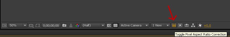

I can't say for sure since I haven't really dealt with HDV, but 1440x1080 is closer to square than 16x9. 16x9 would be 1920x1080, so the HDV footage is getting unsqueezed in FCP to the proper ratio. In AE, it isn't. Right below your viewer window, try turning on the aspect ratio correction checkbox. It will probably look correct now in terms of aspect because it's getting unsqueezed (like anamorphic film footage), even though it looks all blocky and terrible in the preview. Seems like you're doing things right, and FCP is just automatically correcting the ratio.

You need to check your Interrupt Footage settings in AE, make sure it's correct there. If I were you, and the best workflow for these types of things, would be to work in square pixels throughout. Drop you HDV footage into a ProRes square timeline, then export out a 1920x1080 QT for AE. It's easier that way and you work in a more robust codec vs. the crap color space of HDV.
Your comp settings looks correct, and there's really no reason to work in any other aspect ratio, than your base materiale. Try clicking the button, as show on my image. Should fix you right up in the preview.
Remember to set the correct aspect ratio of 1.33 when you export as well. Otherwise you might get a square output (which really isn't a problem if you bring it back into FCP, where you can force it to fit the frame).
