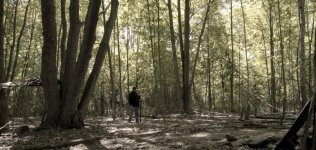

Looking for ideas for creating a soft haze (not fog) in a small forest clearing about 75 ft in diameter.
I'm trying to capture the look of the sunbeams coming through the trees, plus give the location some depth and visual interest.
The only caveat is there is no access to electricity and I'm trying to stay clear of using generators.

Hey everyone, thanks again for the replies!
Just wanted to post an update on my hair-brained mosquito fogger idea. I actually went ahead and bought one at Walmart.
I paid $60 for it, but then immediately received a $40 price adjustment.(???) So it basically ended up costing me $20!!! (plus $4 for the propane cylinder)
I filled it with Froggy's Fog Juice and Voila! It kicks out some serious fog!!! I'm not looking for that "foggy' look, just hoping for a bit of 'atmosphere'; some visual interest in the wide shots. I think this might just work! (?)
Next step: Test it on the location. I will post the test results at a later date.
Check out the photos of the un-fogged location and the fogger in action...
