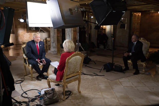

I assume he means those 60-minutes-style interviews that are shot on several cameras where the interviewer and interviewee both have their own shots and lights are usually put above/behind their heads just above frame to get even, near-on-the-nose lighting on both subjects and sometimes doubling as backlights but the lights are tilted down to keep them off the background.
Like this?
http://cbsnews3.cbsistatic.com/hub/...339f74adbafcfead118d41/dsc09698-1600x1600.jpg
Ahh, that makes more sense, standard cross key setup. I usually use a 9' matte boom pole on a combo or three riser stand for each key as to keep the stand out of the opposing camera's image. Speed rail can work too but that's a bigger, heavier setup that takes more gear and more crew to set up and break down. A lot of it is dictated also by if you are rolling just two or if you are rolling three or four cameras.
