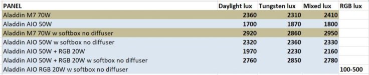

I did a photometric reading comparing the Aladdin M7 and Aladdin AIO RGB at 1 meter:
My own conclusion so far is this. The Aladdin softbox is a must have. As theses panels have such a wide beam angle they gain a healthy bit in light output when the beam is made narrower as the softbox does. I didn't put any diffuser on front of the softbox as I wanted to measure pure raw output power.
When the new Aladdin All-In-One (AIO) panel is used with both bi-color and RGB I ended up with almost as much output as the M7 panel. But this is also tricky as the RGB can't be made to output pure white and given the app or dimmer on the back of the panel shows no reading to which color being output.
In daylight the M7 is the better choice as it puts out more light.

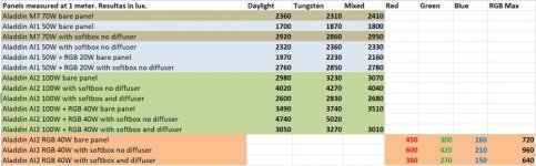

I liked this panel so I got the All In 2 100W+40WRGB panel and put photometrics in an updated chart. I must say I'm impressed with this new panel as it provides both power, refinement and skills.
I noticed one oddity while measuring. At certain settings the panel increased output by about 100 lux over a couple of minutes. On other settings it stayed. As long as it was an increase I'm not complaining but it's good to know.
