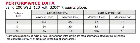

Yeah, the CRI is impressive but, the thing is, 25 FC at 10 feet is less than the output of a Mole-Richardson type 2351 200 watt Midget Solar Spot Fresnel at maximum flood (30 FC at 10 feet, beam diameter 8.4 feet). At full spot, the Midget puts out 295 FC with a beam diameter of 1.3 feet. That Hexolux light will probably cost $1500 to $2000 or more. I picked up my Mole Midget used for $120.
Mole Richardson type 2351 photometrics.
