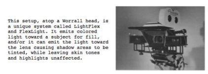

Flashing is not the same physical process as 'spiking' a lens to reduce contrast... but the results are very similar. Check this out, it's a device that can send light into the lens for this reason or toward the subject to give either a lift in the shadows or a colored tint to the shadows.
