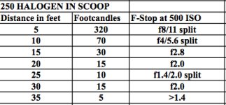

Ok. That being said.... There is no way I would buy the lights that you linked to. Why would you want to spend over $400.00 for a LED light with a CRI (Color Rendering Index) of 82 and with absolutely no information as to its photometric performance? I mean, shot, with that kind of $$$, you could get a 250 watt E-26 Medium base halogen bulb, that will screw into any standard house hold socket (In North America), put it in a versatile spring clamp work light and have photometrics like this:
... and then have $390 left over for Beer, Pizza and Dancing Girls!
I know, it is not that simple, but if you are contemplating buying lighting gear off of eBay you have to really delve into the site and see what is out there. ... "Continuous Lighting" in "Cameras and Photo"!
