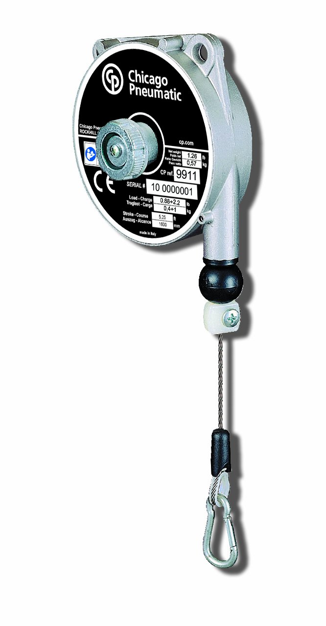

Well, I work in the industrial industry and if you are looking to add a device that would retract and allow you to balance a camera i would look at something like this:
http://www.amazon.com/Chicago-Pneum...&qid=1402108372&sr=1-1&keywords=tool+balancer
We use these to almost the same thing on assembly lines to hold the tool suspended in air for easy access and use. You can adjust the tension and the retracting ability. It would be great to mount it to your rig above and string the cable where the actual unit is int he back of you not at the top.

I have done some research and found the best options seem to be tool balancers as Aaron Jones has said. Take for example this:
http://cinemaoxide.com/zero-g.php#
Some of you out there may have seen this contraption before. This is a prototype, as far as I can tell, which uses an adjustable tool balancer, particularly an Aero-Motive brand from what it looks like. You can get one to match the weight of whatever camera you want to throw on it. Search for them on eBay, they go for $100 or under for an 18-24lbs version.
