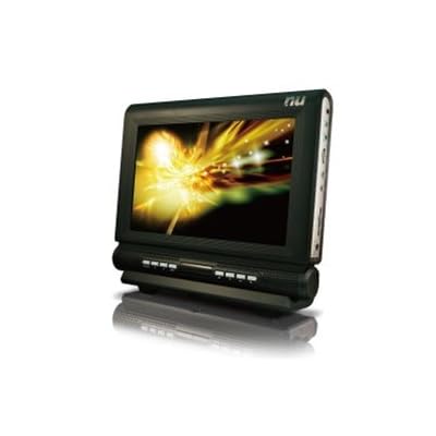

I found this 9 inch monitor that is 680X800 and that is "ultra slim and lightweight"
http://www.amazon.com/CineTrek-Port...8?ie=UTF8&s=electronics&qid=1207190175&sr=8-8
Depends on what your idea of a jackpot is :-)
That unit has 800x480 resolution and composite video input, no option for component in. You would have to try one and and see if the video quality is high enough to suit your needs.
For about $250 to $300 more, you could get a ToteVision 703HD which has the same resolution but is probably built a bit sturdier, has the mounts built in and the ability to take composite as well as component inputs supporting up to 1080p.
Cheers,
It would be but you have no way of feeding it an hd source. If you have a dvx your good, but yellow rca composite won't cut it for HD focusing. The problem isn't finding a decent res small monitor it's feeding it the right signal.
