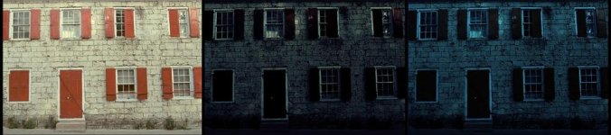

Transform the image to low key by lowering overall exposure a little bit. There is obviously little light. If there are no highlights to capture, do it in post to get better signal per noise.
Lower grey exposure a lot to achieve a low key image. Gamma perception changes in low light, the middle grey is a lot lower compared to daylight.
Undersaturate a little bit, the eye does not see much color in low light. Low light is handled mostly by the rods, the cones are not sensitive enough.
Distort the color balance to blue. Scotopic vision has more blue. Don't overdo it, it screams day for night processing.
I wouldn't use a plugin, they generally look unnatural.
Check on a monitor with good black calibration. Low key images are full of surprises. Check on a gamma of a computer (2.2) and on a CRT if possible (2.5).
All this is personal preference of course, not nuit américaine.
No 2 is realistic, no 3 is popular.
EDIT: larger image (which was reduced to the size of the original image lol)
