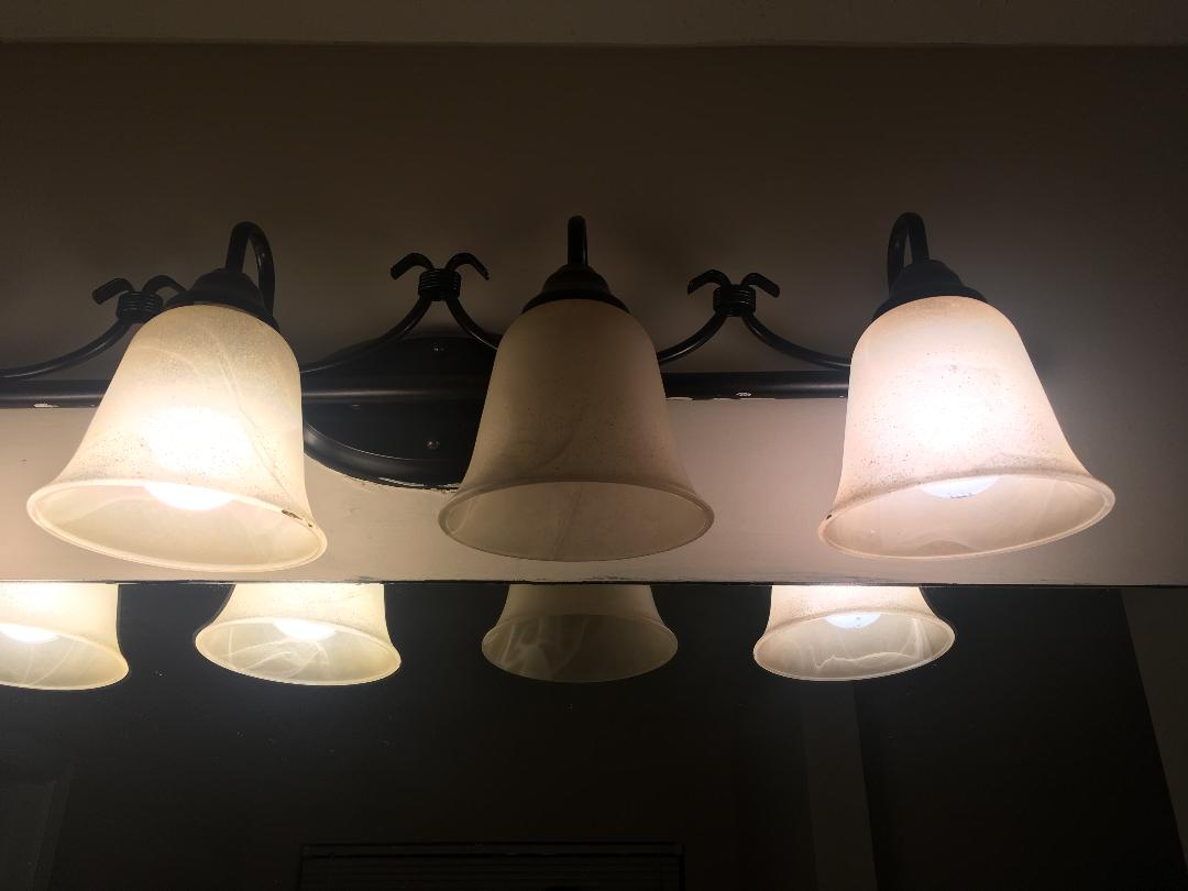

I have some GE single color LED bulbs now mixed with tungsten bulbs. The colors look pretty fine to my eye, not really noticeably different than tungsten bulbs. Here's a photo where some of the bulbs are LED and some are tungsten. As I said, I had trouble dimming them so there is that issue.
