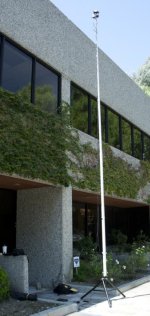

I made a super tall camera a year or so ago to mount a Sony AVCHD camera
I used three parts
For the head http://www.bhphotovideo.com/c/product/64399-REG/Bescor_MP101_MP_101_Motorized_Pan_Head.html
for the body i used a retractable flabpole but instead of the large gold ball on the top I added a 1/4 20 screw which is all you need to mount that bescore head
Then i used a speaker stand as my base
http://www.google.com/search?q=spea...20&bav=on.2,or.r_gc.r_pw.&fp=a40f3cd63ecc4954
I opened up the bottom of the flag pole and let it sit on top of the speaker stand and added 8 screws that tighten it down.
The bescore head has plenty of power to hold a dslr and can run off of 4 aa batteries for about 12 hours of use or it can run on ac.

That's encouraging news. I had actually seen one of those gold-ball flag poles and considered it but wasn't sure if it could handle a 15lb payload and I'm not to confident in the locking mechanisms in the product linked to above.
Can I ask how high it went and how stable it was? I think I'll need guy wires to keep it from moving around during a 30min or hour-long time lapse but that's no big deal.
that pole looks very similar to the one i bought. I use it to film football games and it has taken a couple of hits after field goals and not gone down. It has very little surface area so it doesnt move much due to wind or anything. It also has a couple of rings that i use to hold down the cabling. Including the stand it is about 22ft high. Guy wires wouldn't hurt but i don't require them.
http://www.hi-pod.com/?gclid=CN6d_pDp56cCFQkCbAod2CKVcQ
thats the commercial answer for what i was doing and it runs you anywhere from 7-10 grand. Mine complete including camera and monitor was about $800. later today or tomorrow when i get back to the office i will throw up some pictures. They are on my desktop at work.

So thats the package there. It collapsed down to about 8 feet when the pole was retracted.
