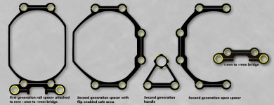

Hey Cory here! Well it's no secret I've been developing a cage/rail mounting setup. I'm working out a simple bug where one of the cage spacers needs to be extra wide on 1 side or have 1 side open to accomodate the prizm flips of various adapters. Ie: Letus, SG Blade, Redrock, Brevis. I've only used my own adapter in efforts not to copy any functionality and start with a fresh perspective. It would be of much help at this point to myself and I hope many others to know the dimensions of many adapters. I'm certain some of the info is available on various threads or websites. I am also happy to provide dimensions and specs of my adapter as well if anyone wouold like to know.
Thanks all for your time. Here are a couple pics including the most critical dimension I'm interested in. That being the didtance from the lens center to the outer prism nub. Also I would love input on what spacer style would be best appreciated. The open sided bolstered spacer or the extra wide enclosed spacer, both weighing the same. Here is also a close up of the new handle.
