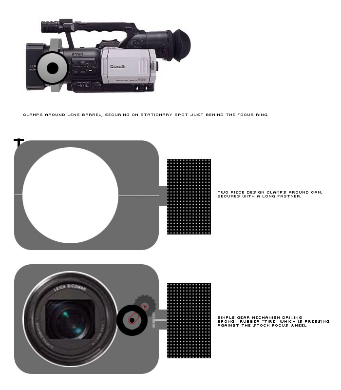

How about something like this? It wouldn't require rails, or the mic mount, etc. Just clamps on and goes.
Re: building a follow focus
KAI :) cool idea, i like it. simple and looks nice. but im wondering what would you clamp it to? not the focus ring cause it needs to turn.

exactly! :) IAL, it would clamp to the solid area just behind the focus ring, and infront of the zoom ring...

there's also the little screw hole meant to hold the zoom handle when not in use. obviously not very sturdy... but maybe it could be used to line up a more solid grip that would clamp around that shaft? this higher position would also allow full access to all the controls on that side of the camera.
