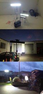

Lesure batt in Numac Accubox with 12v out, cable wired with 'flymo' style two pin connectors through to 'LED 'bar lights' with Cree LEDs these are highly robust fixtures designed for use on 4X4 vehicles.
-Very bright (each fixture draws 120w?)
-A bit green
-the lead acid battery is very heavy - ideally moved on a 'sack truck'
runtime.. long.
